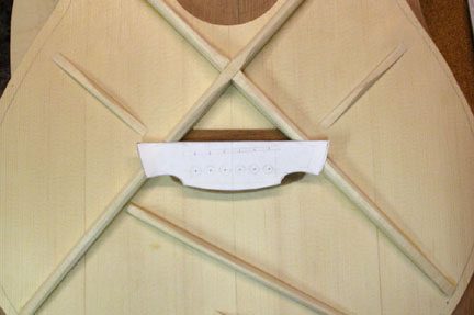

PostPosted: Sun May 14, 2006 6:45 am
Posts: 684
Location: Nashua, NH
Matt,
If I was to go with 12 fret neck with 25.4 scale I’d end up about here.
If I had not committed to the bridge patch, I would consider it.
This is what I am thinking.
This is with 24.9" scale, 13 fret to body.
Does this seem correct?
Wade
Wade
Nashua, NH
http://www.wadefx.com
